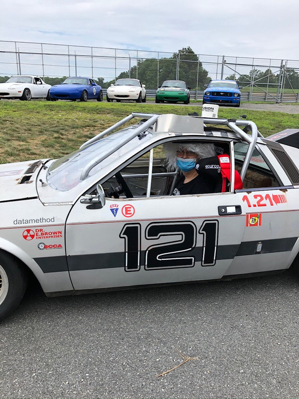

Race Day!!!
Well, everyone loved it. Had a great time.
http://i.postimg.cc/Qx8mKpSQ/Thompson-2020-race-tech.jpg
http://www.youtube.com/watch?v=zTWaW9HB … e=youtu.be
http://i.postimg.cc/dt5B2LSz/Thompson-broken-2020.jpg
Managed to turn 6 laps in total, only 2 under green. Finished 80th out of 79 that started, no idea how that happened, lol. Solid showing for a Lancia.
