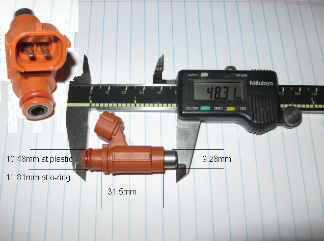

and a request for the people out there watching:
does anyone have 5 injectors like this in the 400-600cc range?
http://frankensteinmotorworks.com/AirplaneMR2/IMG_0110c.JPG
http://frankensteinmotorworks.com/Airpl … _0110c.JPG
Thanks!
Talk to RC injectors or Witchhunter.  I've heard that they can change the ones you have to almost whatever flow that you need.
http://www.rceng.com/
http://www.witchhunter.com/
i was really looking for more of a lemony solution. i know there's no budget restriction as far as jay is concerned but i'm running out of coin over here.

i forgot to mention on the injector question that i do have a set of R1 injectors that i can make fit, but i can't find a spec on them to save my life. they are from a 2004 if anyone has better success than me finding a flow rate.
