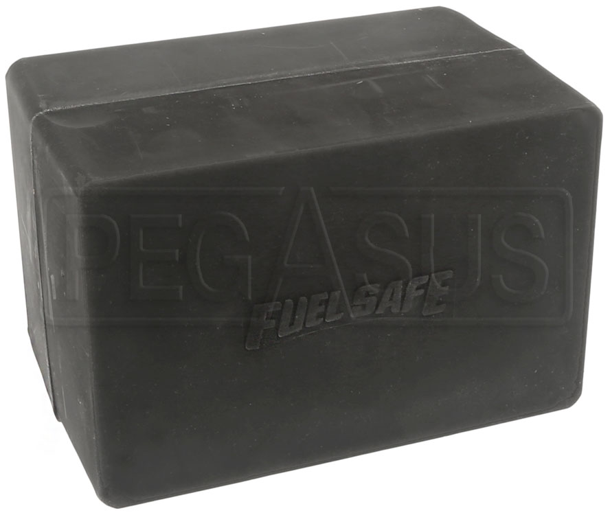

Hi!
I'm a fuel cell.  I'm in a bulkhead, separated from the driver. I was legal last year, but I'm larger than 24 gallons.  That makes me an outcast, just like I was at the 8th grade dance.
http://www.speedwaymotors.com/RS/SR/Product/45820810_L.jpg
I've got these friends who looks like this:
http://www.pegasusautoracing.com/Images/L/2539.JPG
and if I swallow enough of my friends, then I'll be a  24 gallon cell.  Will that make me cool enough to play with the other kids?
Please someone, answer my question.  Then we can resume talking about gas mileage, snipe, møøse bites (they kan be pretty nasti) and all the other things that are on our mynds.

Might be best to email Nick or Jay directly to ensure you get a valid answer to your question.

We're aware of the capacity-reducing blocks, and we wouldn't be opposed to allowing them--we just haven't been able to come up with a satisfactory way of verifying that 24+ gallon cells have the blocks installed. If you guys can come up with a reliable and reasonably simple (ie, not draining and filling everyone's fuel tank) way of verifying the capacity, we're all ears....
How about having the teams that are needing to use them install them right there in tech? Having not ever installed a fuel cell, I don't know if that would be too hard/messy to do on the spot like that. You might need a different lane or special time just for those (few?) teams that have this issue. But it would be the team's responsibility to have already drained the cell before going to tech, show up and show tech that they are being installed, get tech to sign off before the cell is sealed up, and then put in enough gas to show that the cell doesn't leak and passes the kill-switch-kills-all test. How's that for a start of an idea?
What about the next race they run?  Do they have to remove the blocks and drop them in again?

I'd say probably so. Unless you came up with some sort of tamper-proof seal to put over the removable part of the top of the fuel cell. Lemons Tech could put a tamper-proof seal on the part and then the next time they wouldn't have to re-install in front of tech if the seal were still intact, but if it were compromised, they'd have to re-install. Don't know if tamper-proof seals like that are available or not, although with spec-engine series out there, I'd have to think that they are.
The burden is always on the team to prove that they're in compliance with the rules. The only other choice is to just get a smaller fuel cell, right?

Why couldn't you just show up to tech with the blocks already installed and just have the tank completely empty. Then dump the fuel in right there in tech. Seems easy enough to me. Just have the tech guy look in the tank first to verify there is no fuel in the bottom of it before you start dumping it in. Im just curious how many teams will still have those blocks in there at the end of the race??? Maybe and answer to that would be to keep track off all the cars with the blocks in there and randomly drain 1 or 2 of the cars and then fill them back up just to make sure everything is like it was in tech. This would keep people on their toes and might discourage them from thinking about taking them out. Hell you could even do this as a penalty if one of the cars that has the big tank in it gets black flagged.

I think that sounds pretty reasonable, too. Except that some tracks may not allow fueling in the tech area.

Is it really THAT big of an advantage for the middle of the pack teams?  If a car is running up front and nobody sees them fuel for hours, the angry mob will take care of the problem via the People's Curse.  If the cheating team is seen carrying 30 gallons of fuel to the fuelling area, people WILL notice.
I don't see this being any different than running cheater engine parts.  You might get away with it, but then again, you might get crushed.  Is it worth the risk?
